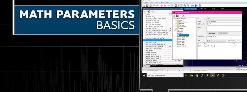

Math Parameters let you create your own virtual measurements inside VCM Scanner. They combine existing channels (like commanded AFR and measured AFR) into a new value that you can log, graph, or chart alongside the factory data.
Think of Math Parameters as a calculator built into VCM Scanner. Instead of exporting your log to a spreadsheet, you can do the math right in the software—live, while scanning or during playback.

- Watch for pink – If your math parameter shows up highlighted in pink, it means you’re using a channel that isn’t being logged.
- Use in filters – Conditional math expressions (true/false) are especially handy for filtering your data.
