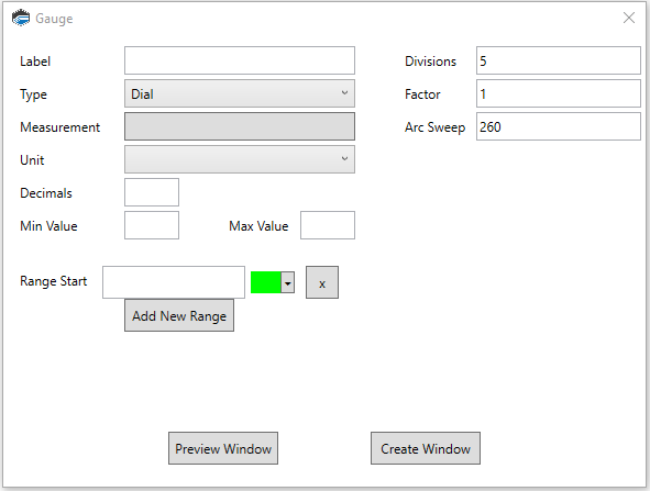

In the menu bar, select Layout > Add Control > Add Measurement. A list of gauge types appears. |
2.
Select the type of gauge to add: Dial Gauge, Bar Gauge or Value Gauge. A window showing the properties for the new gauge appears. |
NOTE: The configurable properties in this window vary by type of gauge.

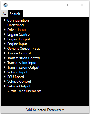

Click the Measurement box. A list of signals appears. |
4.
Select the signal whose value you want the gauge to display. |
5.
Click Add Selected Parameters. |

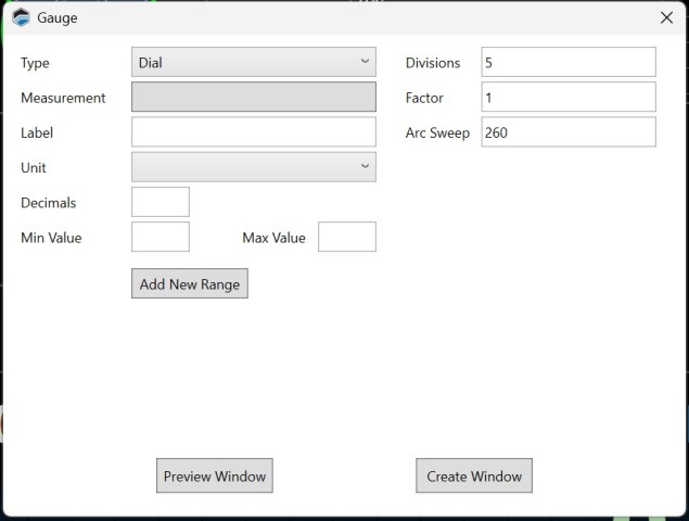

6.
Configure the remaining parameters for the gauge. |
