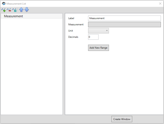

To add a measurement list,
| 1. | In the menu bar, select Layout > Add Control > Add Measurement > Add Measurement List. The below window will appear. |
| 2. | Add measurements to the list (see below for instructions). |
| 3. | When configuration is complete, Click Create Window. |

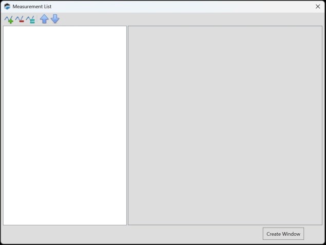

Adding a Measurement to the List
| 1. | Click |
NOTE: Step 1 is not necessary for the first measurement added. One unconfigured measurement is already present in a new list.
| 2. | Search for the desried measurement. |
| 3. | Double-click on the measurement whose output you want to display. |
| 4. | Click Create Window. |
| 5. | Complete signal setup by configuring the signal's parameters. |
Editing an Existing Measurement
| 1. | Select the name of the signal in the column on the left. |
| 2. | Modify the signal parameters displayed on the right. |
Add a new measurement to the list. To complete signal setup, you must configure the signal's parameters. |
Delete the measurement selected in the left column. |
Duplicate the signal measurement selected in the column on the left. |
Move the signal selected in the left column upwards in the list. |
Move the signal selected in the left column downwards in the list. |
