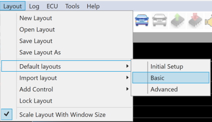

Loading a Default Layout
There are a number of pre-defined layouts listed in the menu bar. To open one of these layouts:
1.
In the menu bar, select Layout > Default layouts and select either Initial Setup, Basic, or Advanced. |
2.
A list of all the tabs included in the selected layout appears. |

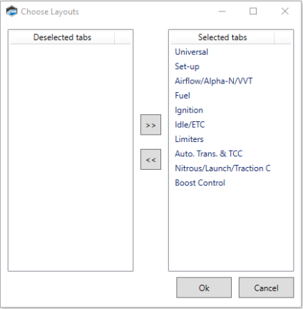

3.
Select the tabs from this layout to load. By default, all the tabs will be loaded. If you wish to remove a tab, |
a.
Select the tab to remove in the right column. |
b.
Click << to move it to the left column. |

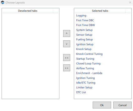

4.
If you wish to reorganize certain tabs, |
a.
Select the tab to reorganize of the right column. |
b.
Click either the ^ or v to reorganize your tabs. |
