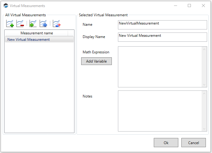

Virtual Measurements
The Virtual Measurements window can be used to create complex values that take into account multiple measurements. Once defined, these parameters can be used in gauges and graphs as if they were output from a sensor or other measurement.
NOTE: In VCM Scanner, measurements of this type are called "Math Parameters".
To open this window, select Log > Virtual Measurements.
The most commonly used virtual measurements are built in (predefined). The software also allows you to add up to 10 user defined measurements.
Defining Virtual Measurements
| 1. | Click . |
| 2. | In the left column, select the new virtual measurement. |
| 3. | On the right side of the window, enter the Display Name for this measurement. This is the name you will see displayed on screen. |
| 4. | In the Name box, enter the internal parameter name used by the software. |
NOTE: This is typically just the Display Name with spaces and other special characters removed. It can be used to include this calculation in other virtual measurements.
| 5. | Enter the Math Expression for this measurement. This is the formula that will be used to calculate the new measurement. See Defining Expressions below. |
| 6. | Click OK. |
