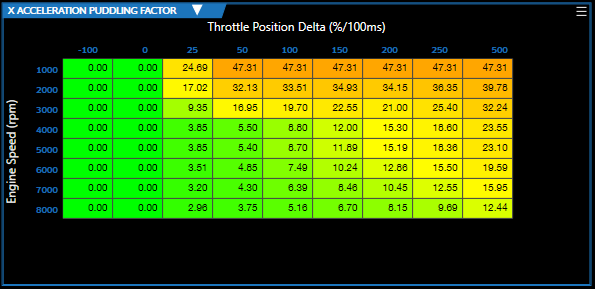

Initially, you will see data presented in a normal table view. This is the primary view for editing table data and the majority of the editor's functions are available only in this view.

Editing Cell Data in Table
Editing cell data has two basic steps:
1. Select the cell(s) you wish to modify.
2. Enter the new cell data or specify how the cell data should be transformed.
The colors of cells whose values have been modified will change. Cells with increased values will appear pink. Cells with decreased values will appear purple.
