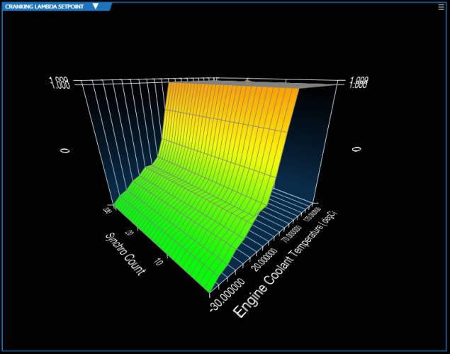

Using 3D Graph View
You can control the rotation, shift, zoom of the 3D graph as well as modify data points with the mouse buttons.
Modifying a Data Point
1. Left click on the data point to modify.
2. Drag the data point to the desired position.
3. Release the left mouse button.
Adjusting the Zoom Level
Roll the mouse wheel up to zoom in or down to zoom out.
NOTE: Laptop touchpads also typically support gestures that allow you to zoom, but they vary from laptop to laptop.
Rotating the Graph
1. Left click the graph.
2. Move the mouse in the direction of rotation desired.
