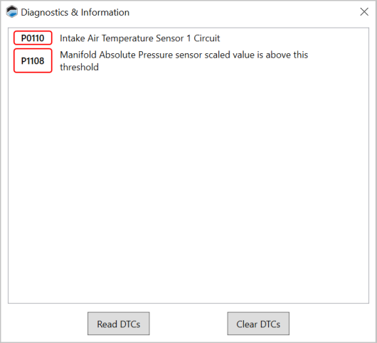

The Diagnostics & Information window can be used to view and clear Diagnostic Trouble Codes (DTCs).

Click . The Diagnostics & Information window appears. |
6.
Click Read DTCs. VCM Live will query the ECU for diagnostic information. When finished, any DTCs detected will be listed at the top of the window. |
