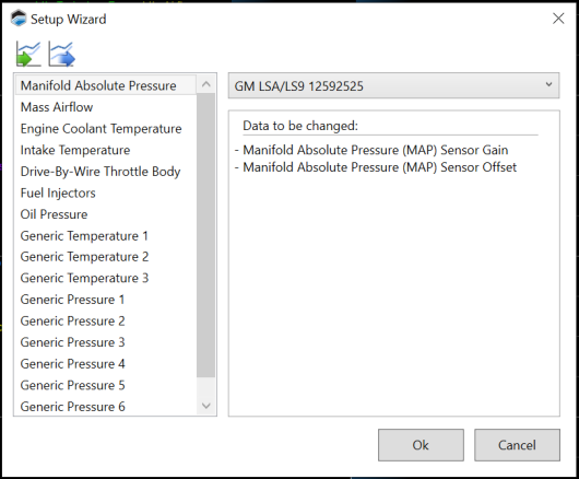

Running the Setup Wizard
The Setup Wizard can quickly configure many of the ECU's parameters based on the hardware actually being used in the vehicle (specific sensor types, etc.).
NOTE: These parameters can also be individually adjusted if your layout includes a configuration interface for them. The wizard simply provides a quick and easy way to configure multiple parameters to the recommended defaults for your hardware.
Follow these steps to run the wizard:

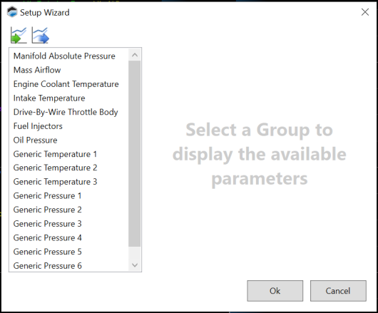

| 1. | In the menu bar, select Tune > Setup Wizard. The Setup Wizard window appears. |

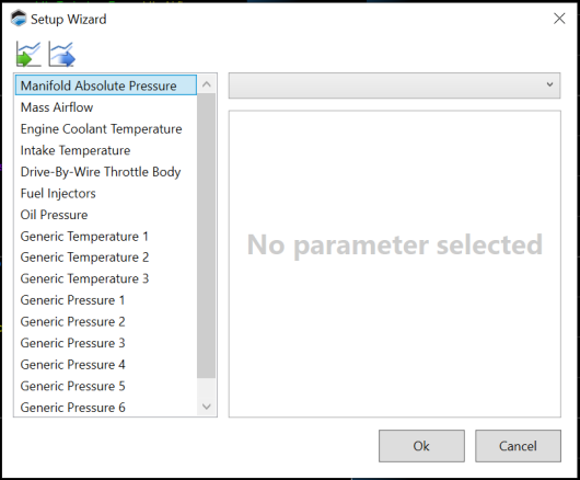

| 2. | In the column on the left, select a group of settings you wish to configure. |
| 3. | Use the dropdown in the top-right of the wizard window to select the hardware installed in the vehicle. The wizard will list the parameters that it will configure for you. |
For full descriptions of these parameters (and others), see the Parameter Guide:https://files.hptuners.com/help/CoreParameterGuide.pdf.
| 4. | Repeat steps 2 and 3 for each additional group you want the wizard to configure. |
| 5. | When your are finished with the groups you want to configure, click Ok. |
