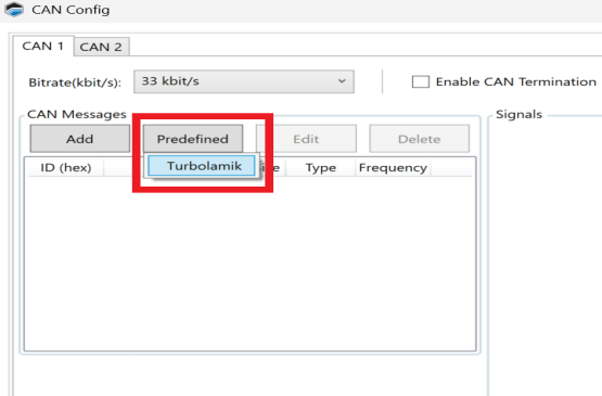

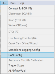

4. In the menu bar click ECU > CAN Config .

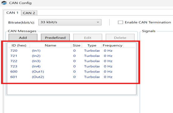

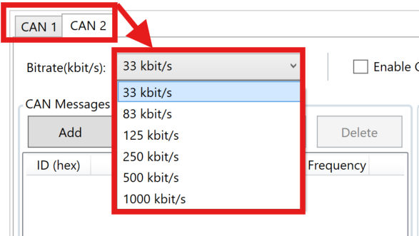

5. In the CAN Config window select the CAN port that is physically connected to the TurboLamik TCU (CAN 1 or CAN 2) and ensure the bitrate matches the bitrate on the TurboLamik TCU.
6. Click Predefined > Turbolamik.
CAUTION: These are grouped messages, if one gets deleted the entire group of messages will be deleted.
7. Click Ok.

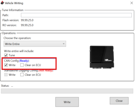

8. Click icon to write the CAN config changes to CORE.
NOTE: Ensure "CAN Config (Ready):" Write check box is checked off (refer to image below).
9. Click Write.
10. TurboLamik Can Configuration is now complete, refer toTurboLamik VCM Live Setup Procedure to setup all TurboLamik associated Parameters.

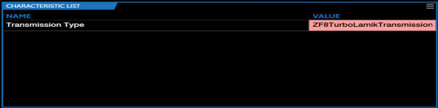

4. Ensure to change the characteristic Transmission Type parameter to the ZF8TurboLamikTransmission value.

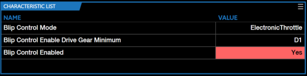

5. Enable Blip Control , by selecting the below values for all of the below characteristics.
NOTE: CORE Blip Control allows users to set a defined throttle position during transmission downshifts. This feature is exclusively applicable to the ZF8 transmission.

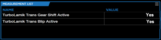

NOTE: "TurboLamik Trans Target Gear" - "TurboLamik Trans Current Gear" indicates downshifting.
NOTE: Blip Control is activated when all of the above conditions are met.

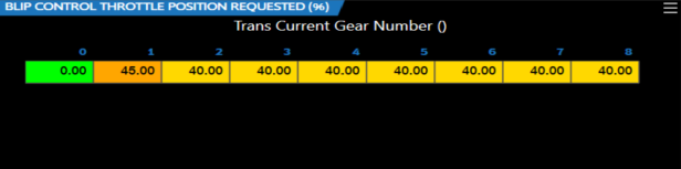

a. "BLIP CONTROL THROTTLE POSITION REQUESTED (%)
NOTE: This table defines the throttle position during a blip.

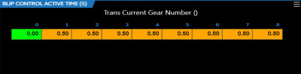

b. "BLIP CONTROL ACTIVE TIME (S)"
NOTE: This table defines how long the blip is maintained. Once a downshift blip is triggered, no additional blip will be allowed until the defined duration has elapsed.

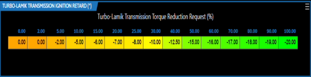

8. Utilize the "TURBO-LAMIK TRANSMISSION IGNITION RETARD (°)" characteristic to retard the ignition angle (spark) to enable smooth transmission shifts
NOTE: TurboLamik provides the torque reduction (%) to CORE, which then uses this input to retard the ignition timing based on the below table.
