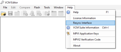

| 2. | Open VCM Editor. |

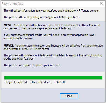

| 3. | From the Help menu, select Resync Interface. |
| 4. | If the Sync was successful, the progress bar will indicate that the operation is complete. |
