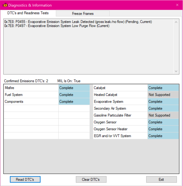

6. Click . The Diagnostics & Information window appears.
7. Click Read DTCs. VCM Scanner will query the vehicle for diagnostic information. When finished, any DTCs detected will appear in the top half of the window.
8. Some vehicles report additional "freeze frame" data for individual DTCs. If this data is available for your vehicle, it can be viewed on the Freeze Frame tab.
9. Use the provided information to resolve as many issues as possible before tuning the vehicle.
10. If desired, you can click Clear DTCs to tell the vehicle that the issue has been repaired.
