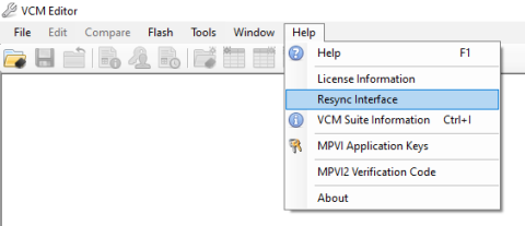

2. Open VCM Editor.

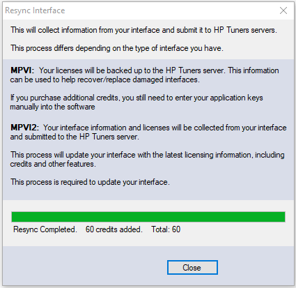

3. From the Help menu, select Resync Interface.
4. If the Sync was successful, the progress bar will indicate that the operation is complete.
