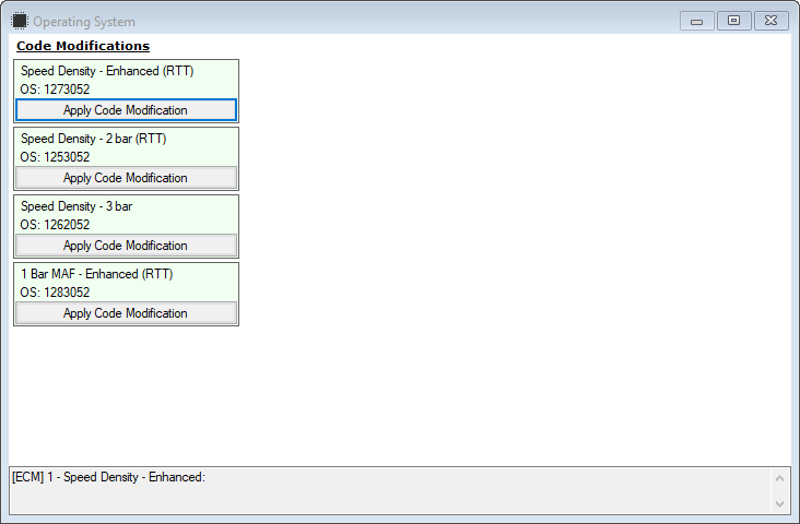

VCM Suite can apply operating system enhancements that add RTT to many vehicles that have an LS1 engine from GM. If your vehicle supports these enhancements, you will see them listed on the OS tab in VCM Editor.
Details for these custom operating systems are included below. See Applying a Custom OS with RTT for instructions on applying any of these custom operating systems to your vehicle.
