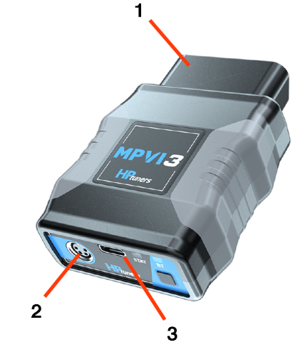

Input / Output Ports
Port
Description
1
OBD-II Connector. Attaches to the OBD diagnsotics port on your vehicle. See Where is My OBD Diagnostics Port? (below) fo more information.
2
M8 Connector. Used to connect additional sensors and CAN bus inputs via the ProLink+ Cable from HP Tuners.
3
USB Type C interface. Used to connect to a Windows-based PC or laptop. Use of a high quality USB cable, such as the one included with the device, is strongly recommended.
