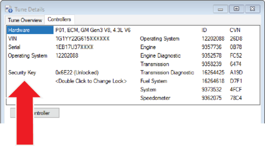

You can find out if the vehicle's controller supports Tuner Locking by doing the following:
1.
Open the tune file that you want to lock. |
2.
In the menu bar, select, Edit > Calibration Details. The Tune Details window appears. |
3.
Select the Controllers tab. |
4.
If the ECM supports Tuner Lock, the words Security Key appear here, with the actual key directly to the right. Below the key, the words <Double Click to Change Lock> will be displayed. |
