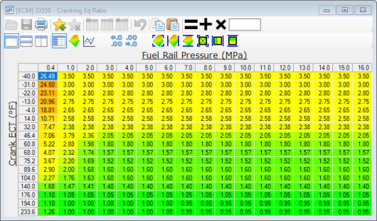

When you first open the table editor, you will see data presented in a normal table view. This is the primary view for editing table data and the majority of the editor's functions are available only in this view.
You can also switch to either a 2D or a 3D graph view:
Switch to 3D graph view. In addition to zooming and rotating the chart, this view allows you to drag click and drag individual data points. See Using 3D Graph View for more information.
Selects the 2D graph view. This view allows you to click and drag individual data points. See Using 2D Graph View.
Return to the default table view.

Editing Cell Data in Table
Editing cell data has two basic steps:
1. Select the cell(s) you wish to modify.
2. Enter the new cell data or specify how the cell data should be transformed.
NOTE: Right-clicking on a cell produces a menu that contains additional options for manipulating cell data. See Table Editor Right-click Menu for more information.
