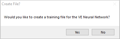

4.
VCM Editor will display a prompt like the following for each supported neural network found in the tune. |
5.
If you wish to train the indicated network, create a training file: |
b.
Enter a name for the new training file. |

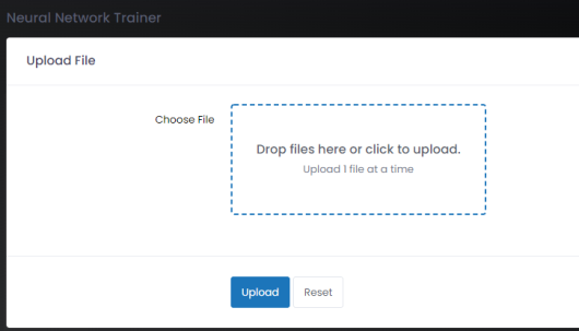

6.
Navigate to tunertools.hptuners.com. |
7.
Log into your account. |
8.
Select Neural Network Trainer. |
9.
Upload all files created in steps 3 through 5. |
10.
Once all files have been processed, a Download button will become available. Download all files. |

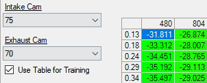

14.
Modify the generated VE tables as desired. Follow these steps for each table: |
a.
Use the dropdown menus on the left to select a cam angle combination. The corresponding VE table will appear on the right. |
b.
If you want to use this table for training, check the Use Table for Training box. |
NOTE: You can accelerate the process by selecting fewer tables for training. However, this reduces training accuracy.
NOTE: Deselecting a table can also be used to disable unused VE tables. For example, Dodge/RAM/Jeep vehicles with Hellcat engine only use a fraction of the 25 available tables.
c.
If you are using this table, edit the table values as desired. |
NOTE: Editing a large number of tables may take several sessions. If needed, you can save your progress using the Save Current Progress button and then come back later.

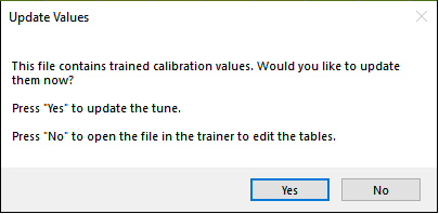

21.
In the menu bar of this window, click . |
22.
Browse for and open the file saved in Step 19. VCM Editor will prompt you to update the file with the new calibration values. |
If you want to flash the vehicle with these values, click Yes. This will close the Neural Network Trainer window and update the tune to include the trained values. Proceed to Step 23. |
If you would like to continue editing the trained tables, click No and return to Step 14. |
