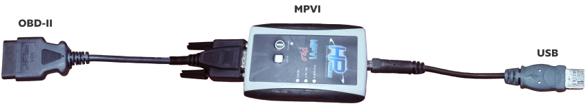

MPVI
1.
Connect the larger end of the included USB cable to an available USB port on a laptop with VCM Suite Installed. |
2.
Connect the other end of the USB cable to the USB type B port on the interface device. |
3.
Connect the 15-pin side of the OBD-II interface cable to the matching connector on the interface device. |
4.
When you are ready to scan or reprogram the vehicle, connect the 16-pin side of the OBD-II interface cable to the vehicle's diagnostic port. |
