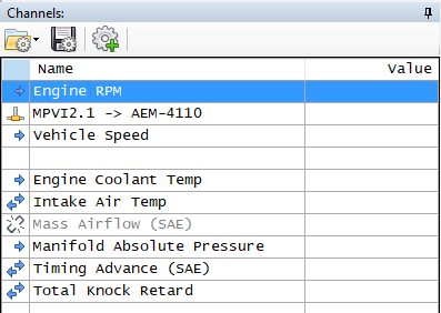

Channel Icons
The icons in the left column indicate the type of each channel:
A polled parameter. Although the vehicle's controller can provide this information, VCM Scanner has to ask the controller to provide it. This adds processing load to the system. So, adding a large number of these to the channel list could potentially slow down the rate at which scan data is received. |
A broadcast parameter. The vehicle's controller is constantly broadcasting this parameter, whether VCM Scanner asks for it or not. Therefore, adding these to the channels list does not impact system performance. |
An unsupported parameter. The controller in the current vehicle cannot provide this parameter. |
An external input. The parameter is provided by an external device (typically a sensor) connected to your computer through one of the following:
External inputs do not impact system performance. |

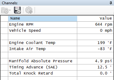

Data Log View
When live scanning or when a log file is loaded, the Value column displays the output of each channel at the current time index.
NOTE: When this view is displayed, most channel configuration options are not available. To configure channels, you must stop live scanning or close the open log file.
