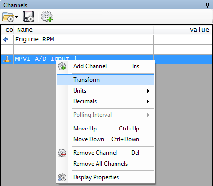

On the Channel display, you can right click a channel to bring up the menu. If the channel supports transformation, you will see an option called "Transform".

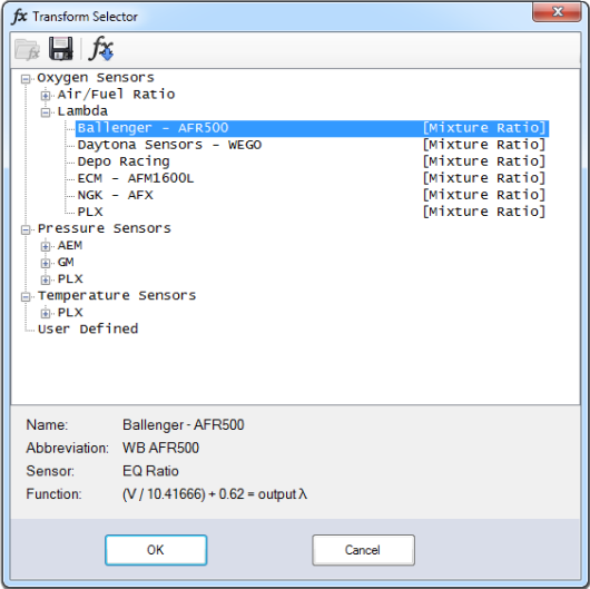

The Transform Selector form will show you any transforms that apply to the channel you have selected.
For example, if your base channel is a voltage input, the Transform Selector will show you transforms that take voltage as the input.
If your transform is not listed in the Transform Selector window, and you would like us to add it, please contact our customer support department and we can look into adding it to a future build.
