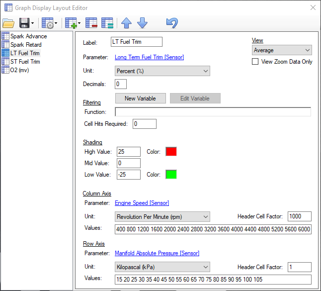

Adding a Table
| 1. | Click |
| 2. | Click the Parameter link. The Parameter Selector window appears. See Selecting a Parameter for more information on this window. |
| 3. | Double-click on the parameter whose values will be mapped in the cells of the new table. A blank table should now appear on the Graph panel. |
NOTE: Your channels list must include a channel that provides the selected parameter. If you don't have a channel to do this, VCM Scanner won't query the vehicle or the external input for this data and may not know how to transform the raw data received into meaningful values.
| 4. | Complete graph setup by configuring the graph's remaining parameters. |

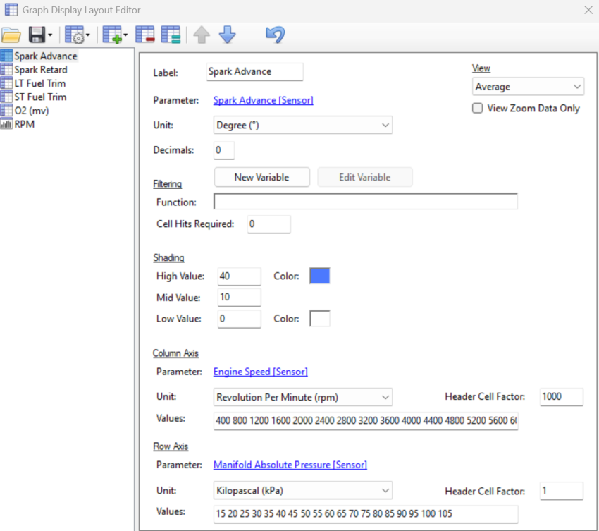

Editing an Existing Graph
To modify a graph that is already included in this layout:
| 1. | Select the name of the graph in the column on the left. |
| 2. | Modify the graph parameters displayed on the right. |
