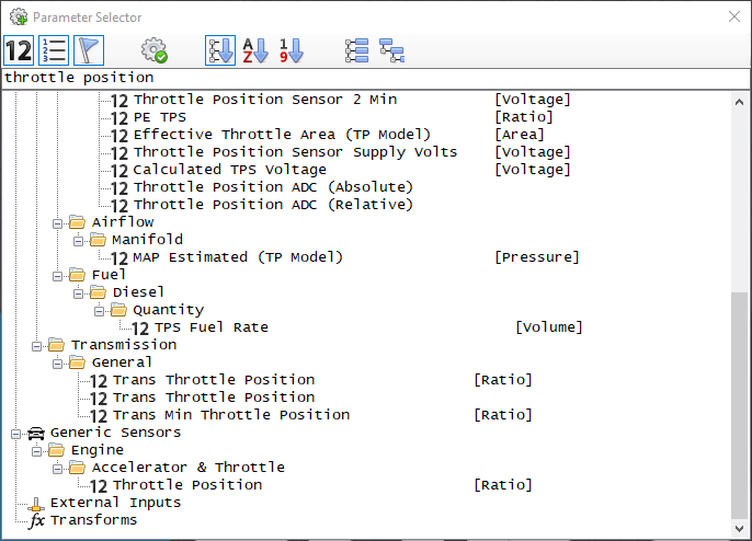

| 2. | Click the Parameter link. The Parameter Selector window appears. |
| 3. | Search for throttle position and select (double-click on) the Throttle Position sensor in the Generic Sensors group. |

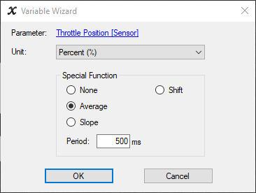

| 2. | Click New Variable to open the Variable Wizard again. |
| 3. | Select the same Parameter and Unit that was selected in Part 1. |
| 4. | In the Special Function box, select Average and enter a Period of 500 ms. |
| 5. | Click OK. Our expression should now look like this: |
