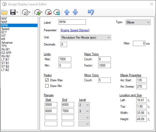

The layout editor is used to add, remove. and configure individual gauges. To open this window:
| 1. | Right click on the gauge display. |
| 2. | Select Gauges Layout. |
NOTE: Changes take effect immediately (without saving your changes to file).

| 4. | Complete gauge setup by configuring the gauge's parameters. |
Editing an Existing Gauge
To modify a gauge that is already included in this layout:
| 1. | Select the name of the gauge in the column on the left. |
| 2. | Modify the gauge parameters displayed on the right. |
