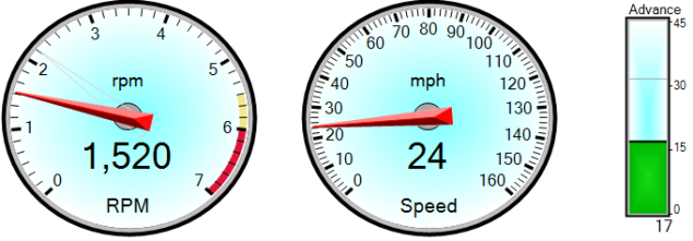

Limits - Max |
The highest value that the gauge will be able to display. For example, the Speedometer above has a Max of 160. |
Limits - Min |
The lowest value that the gauge will be able to display. For example, all three gauges above have a Min of 0. |
Major Ticks - Count |
How many numbers appear on the outside of the gauge? For example, the RPM gauge above has 8 numbers (0 to 7). |
Major Ticks - Factor |
The raw value will be divided by this number to produce the numbers on the gauge face. For example, the RPM gauge above has a Factor of 1000 so that it displays 0, 1, 2... rather than 0, 1000, 2000... |

Minor Ticks - Count |
The number of ticks between each number on the gauge. |
Ellipse Properties - Arc Start |
The position (in degrees) of the lowest value on the gauge. Both round gauges start at 135 degrees. (0 degrees is at 3 o'clock). |
Ellipse Properties - Arc Sweep |
How far around the edge of the gauge (in degrees) does the numbering go? Both round gauges above use a value of 270 degrees (the numbers go 3/4 of the way around the gauge, clockwise from the Arc Start). |

Some gauges (such as the RPM gauge in the default layout) have color bars along the outer edge. To configure a color bar, fill out the Start, End and Level values in a single row of the Ranges section. Each color bar will use one row in this section.
