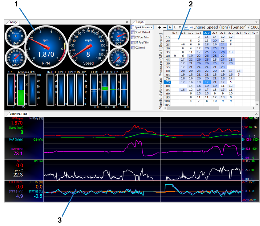

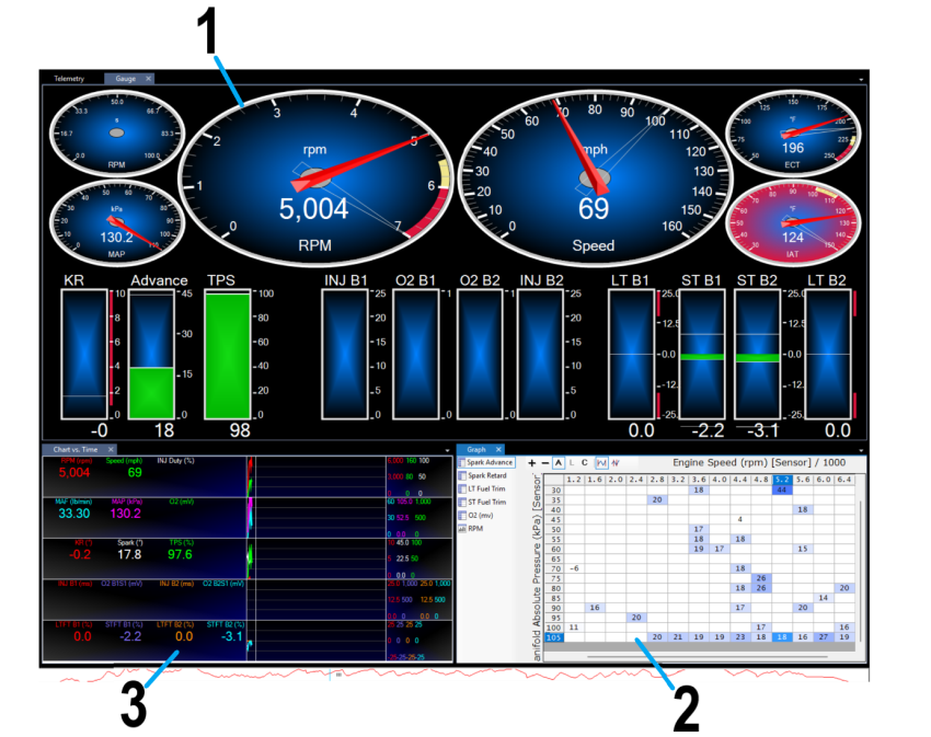

1 |
Gauge Panel |
Gauge panels represent sensor data and/or PIDs as gauges in a cluster. See Gauge Panel for information on using and customizing these panels. |
2 |
Graph Panel |
Graph panels represent sensor data and/or PIDs in a table format. This can be useful if you are gathering sample data to populate a table in VCM Editor. See Graph Panel for usage and customization instructions. |
3 |
Chart vs. Time Panel |
This type of panel charts the value of sensor outputs or PIDs over time. See Chart vs. Time Panel for usage and customization instructions. |
NOTE: All panels are highly configurable. As long as you have channels setup to supply the data, they can display whatever performance and/or troubleshooting data you need to see.
