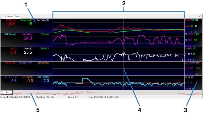

This type of panel displays line charts of the selected parameters over time. When scanning a vehicle, these charts are drawn in real time. During playback of a log file, they display a time window surrounding the current time index of the playback.
Item |
Description |
1. |
Current Parameter Values. During live scanning, this area displays the current values of the parameters being tracked. During Playback, it shows the values at the current time index. If a parameter is stuck at zero or displays no data at all, check your channel setup. Either you don't have a channel that supplies this data or the vehicle doesn't support it. |
2. |
Parameter Line Charts. Tracks the value of the displayed parameters over time.
3. |
Vertical Axis Labels. There are three labels here for each line chart (color coded by parameter). The top value corresponds to the top edge of the chart. The middle value corresponds to the horizontal line through the center. The bottom value corresponds to the bottom edge. |
4. |
Time Index. During playback of a log file, this vertical bar indicates the current time index. All data displayed in the layout reflects the values at this moment, including:
When playback is paused, you can examine the values at a specific moment by clicking anywhere on the line charts. The bar will move to the position clicked. |
5. |
Timeline. When playing back a log file, the timeline represents the total length of time captured in the log. Drag the slider to move to a different time index. Appears only when a log file is open. |
