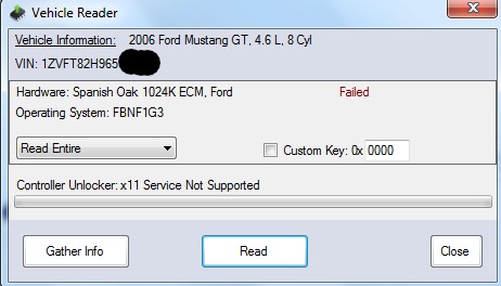

x11- Controller Unlocker "Service not Supported" (FORD ONLY)
Problem
This error occurs in Ford vehicles when the ignition is not being cycled as the software requests, there is an issue with the vehicle's ignition switch, or the interface has a bad chip.
Resolution
