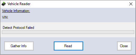

Error Message: Detect Protocol Failed
Problem
The Detect Protocol Failed error is caused by noise in the vehicle's communications or because an MPVI2/2+ needs to be resynced.
Resolution
