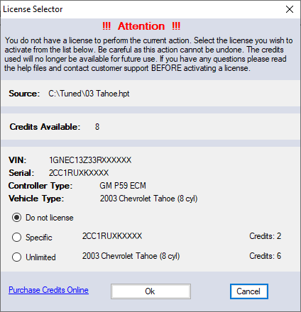

If you do not yet have a license that covers the vehicle you are working on, the software will prompt you to purchase a license when you attempt to flash those changes to the vehicle. See License Activation Rules for more detail on licensing requirements.
The prompt the software displays looks like this:
NOTE: Prices for licenses are listed in credits. Credits are the currency HP Tuners uses for license transactions. See Credits for more information.
Choose the desired option and click the Ok button. The appropriate amount of credits will be deducted from the credits on your MPVI2/2+.
