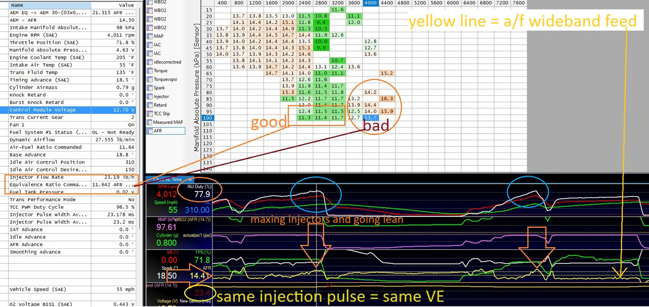

1. You removed the force motor current from the log so I cant see what the transmission is thinking, need to put those back into the log, there are a couple other things I want to see but we have more pressing matter to attend first
2. Looks like the fuel pressure is dropping as rpms climb during 'wot' , this needs to be investigated immediately and fixed before moving on to make the engine powerful
I made a teaching example so everybody can learn what this looks like and how to spot this issue
https://i.postimg.cc/765bwQ0s/novice...ng11-22-23.jpg
Attachment 139809
Here is what we need to notice
-The injector duty rises appropriately
-The injection on-time in milliseconds is relatively stable and flat as it should be for cylinder fill near peak VE
-The commanded air fuel and actual air fuels are matching quite well early on, but then the air fuel gradually goes lean as rpms rise, way too lean to be realistic VE change or air mass changed
The correct way to move forward is install a mechanical fuel pressure gauge to verify the issue by watching the gauge 'taped to the windshield' while driving to show this issue in real time. Do not put a mechanical fuel pressure or oil pressure gauge inside the vehicle as it can leak and start a mess or fire.
The other issue I see is you are approaching 80% duty cycle by 4000rpm already even though its too rich for now I think this is telling us that the injectors are too small overall besides the point. But one thing at a time.
To recap or summarize you should be watching the wideband feed or 'yellow line' during these runs and pulls and making sure it stays nice and rich. We shot for 11.6's starting out for safety its fine. Our new VE table is hitting that mark perfectly but then the engine leans out as you can see in the yellow line or wideband feed line as rpms rise. We look at injector duty and injection pulse ms to make sure the fuel is being send to the injector command, which it is, so the issue must be with fuel pressure. The only other thing that could cause that is a misfire, but you did not report any misfire or rough running, so I Doubt. Or perhaps the injectors could be so old and worn out maybe they are just not opening properly, but I doubt that as well. Easiest thing moving forward is fuel pressure testing. Mechanical gauge on windshield is the sop routine. Maybe time to re-think your fuel system anyways. I would like to see you install new injectors and a new fuel system with a aeromotive fuel regulator and reference return style system using a vacuum line and regulator under the hood with the fuel pressure set to approx 38psi base fuel pressure and at least 60lb/hr injectors from fuel injector clinic or injector dynamics or an OEM cleaned adequate set as we discussed many times.
