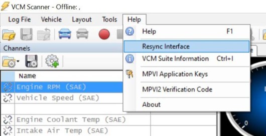

3.
In the menu bar, select Help > Resync Interface. The firmware will update automatically. |

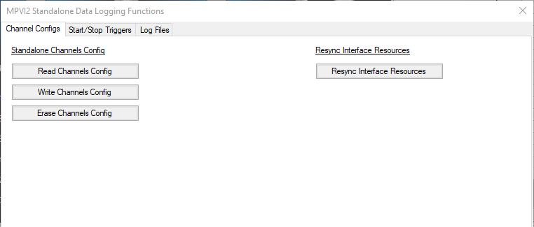

In the menu bar, select Vehicle > MPVI2 Data Logging. |
5.
Click the Resync Interface Resources button. It will take 10-15 seconds to update your interface device. |
NOTE: MPVI4 does not need to Resync interface resources. You simply upload a default channel list for all vehicles or specific channel lists for a connected vehicle.
6.
If you want to send your current channel configuration to the device, click Write Channels Config. Otherwise, leave it set to Vehicle Defaults. |

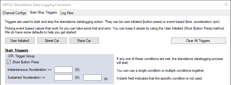

Configuring Start Triggers (Optional)
By default, a short press of the BT button on the device will trigger the start of logging. If desired, you can set up triggers to start logging automatically based on the vehicle's acceleration).
1.
In the menu bar, select Vehicle > MPVI2 Data Logging. If using an MPVI4, select Vehicle > MPVI4 Features. |
2.
Select theStart/Stop Triggers. |
3.
If desired, select either the Street Car button or the Race Car button near the top of the window. This will fill in some suggested values for the Sustained Acceleration fields. |
NOTE: If Disabled is selected under the default section, standalone feature will be turned off and no actions will start the logging process.
NOTE: If Always is selected under the default section, it will always trigger the logging to start everytime the MPVI4 boots and connects.
4.
Configure the fields in the Start Triggers group as desired. You can enter a single condition (trigger) or multiple conditions. When using multiple conditions, data logging will begin when ANY of the conditions are met. |
Short Button Press. If this box is checked, a short press of the BT button on the device will trigger the start of logging. If this box is not checked, a short button press will not trigger logging start. |
Instantaneous Acceleration. If this field is populated, logging will start when the vehicle reaches the specified acceleration. |
Sustained Acceleration. If both of these fields are populated, logging will start when the vehicle sustains the specified acceleration for the specified number of seconds (for example, 0.05 G for 1 second). |
NOTE: If you are using an OBD extension cable, we recommend not using the accelerometer G-forcestart triggers. The interface device is only secure when it is plugged directly into the vehicle’s OBD port. If the device is connected via a cable, it might move independently of the vehicle’s acceleration. As a result, the accelerometer readings might be inaccurate and could result in a false trigger.
5.
When finished, click the Set Triggers button near the bottom of the window, if you are using an MPVI4, click Send Triggers Settings To Interface. |

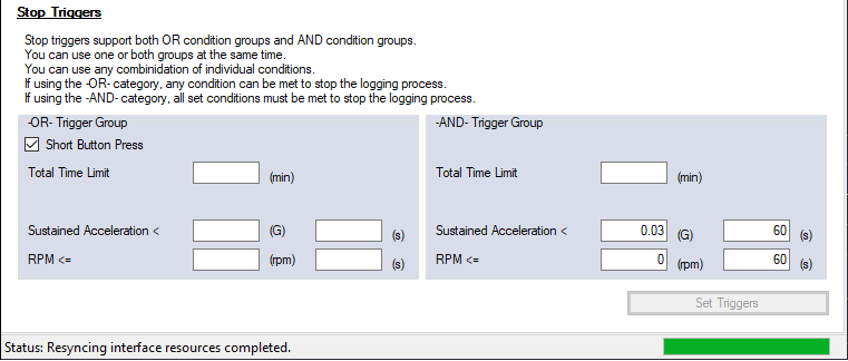

Configuring Stop Triggers (optional)
By default, a short press of the BT button on the device will trigger the stop of logging. If desired, you can set up triggers to start logging automatically based on the sustained acceleration and RPM.
NOTE: Additionally, data logging will stop if there is no movement and zero RPM for 1 minute.
1.
2.
Select the Start/Stop Triggers tab. |
3.
If desired, select either the Street Car button or the Race Car button near the top of the window. This will fill in some suggested values for the RPM fields in the OR trigger group. |
4.
Fill out the fields in the OR Trigger Group and/or the AND Trigger Group as desired. The OR Trigger Group allows you to set numerous conditions. Data logging will stop if ANY of these conditions are met. The AND Trigger Group allows you to set multiple conditions that must ALL be true in order for the data logging to stop. |
Short Button Press. If this box is checked, a short press of the BT button on the device will trigger the stop of logging. If this box is not checked, a short button press will not stop logging. |
Sustained Acceleration. If both of these fields are populated, logging will stop when the vehicle drops below the specified acceleration for the specified number of seconds (for example, 0.05 G for 1 second). |
RPM. If both of these fields are populated, logging will stop when the vehicle drops to the specified RPM or below for the specified number of seconds. |
5.

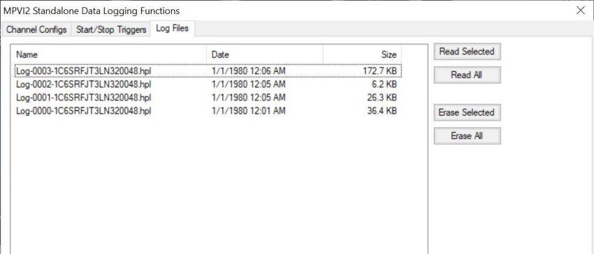

Retrieving Log Files
2.
Connect your HP Tuners interface device to your computer with the USB cable. |
3.

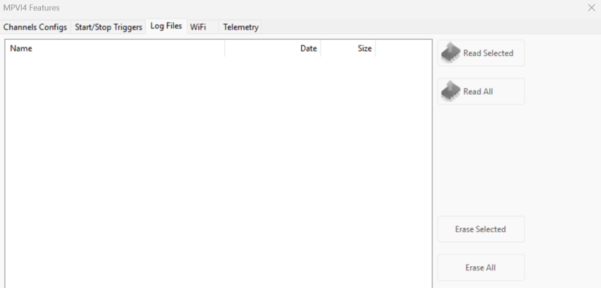

4.
Select the Log Files tab. |
The newest log files will appear at the top of the list. The name will contain the sequence number and the VIN.
NOTE: The MPVI2 does not have a persistent clock, so dates will display the year 1980 unless you connected to VCM Suite, TDN, or TrackAddict during the same power cycle.
5.
Select the log file you want and then click Read Selected. |
6.
Choose a destination folder in which to save the file. |

Standalone Data Logging is not starting (no log file created)
1.
If you are using an MPVI2, verify that the firmware has been updated to v3.1.2 or higher. |
2.
Click the Resync Interface Resources button in the MPVI2 Data Logging window. |
3.
Under Start Triggers, verify that the Short Button Press option is checked and enabled. Then, use the BT button to initiate logging manually |
4.
Ensure that the vehicle’s ignition is ON or the engine is running the entire time. |
5.
Remove the channels from the channel configuration and try again. Click Erase Channels Configbutton in the MPVI2 Data Logging window to reset it to Vehicle Defaults. |
