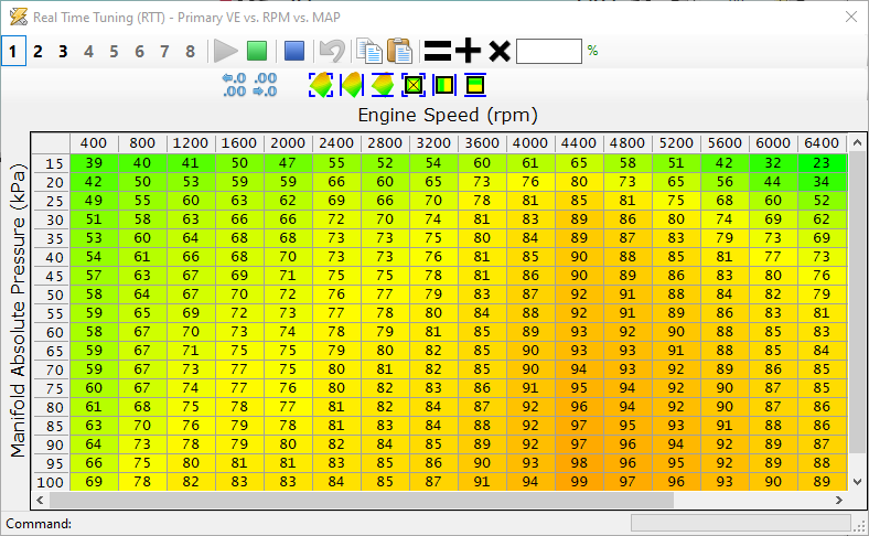

Click this icon to bring up the Real Time Tuning window.
This window is similar to the Table Editor in VCM Editor and includes many of the toolbar icons and the right click menu from that window.
Additional Toolbar Icons
This window includes a few additional toolbar icons that are not present in VCM Editor tables:
Select Table: Each of these numbers represent a table that is available for real time tuning in the current mode. Click a number to select the corresponding table. By default, the controller will use the versions of these tables that are stored on its flash drive. |
Use RAM Version: Instruct the controller to use the version of the selected table in RAM. This allows the table to be modified in real time. |
Use Flash Version: Instruct the controller to user the version of the table on the flash drive. This table cannot be modified in real time. |
Use Flash Version for All: Instruct the controller to switch to the flash versions of all tables. |

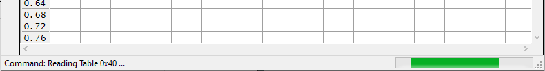

| 1. | Select the table by clicking the number corresponding to the table you want to modify. Initially, the table will appear blank because its data has not yet been retrieved from the flash drive. |
| 2. | Click . This will tell the vehicle controller to copy the table into RAM memory and start using that copy rather than the original table on its internal flash drive. |
