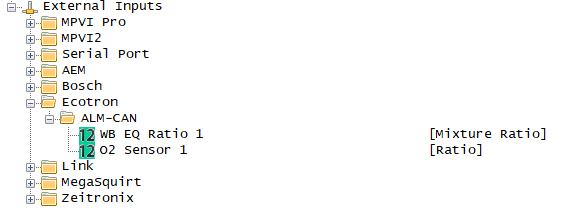

| 7. | Click the icon in the Channels list. The Channel Selector window appears. |
| 8. | All of the folders after the Serial Port folder in External Inputs contain CAN bus inputs (listed by manufacturer). Double-click on the sensor that you want to add. |
NOTE: If the sensor you wish to add is not listed, Contact HP Tuners Support to request that it be added.
The selected input should now appear in the Channels list.
