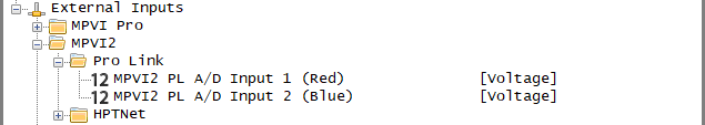

| 7. | Click the icon in the Channels list. The Channel Selector window appears. |
| 8. | Go to External Inputs > MPVI2 > Pro Link and then double-click on the A/D input that you connected the sensor to in Step 1. |
| 9. | The selected input should now appear in the Channels list. Right-click on it and select Transform. The Transform Selector window appears. This window specifies how the raw voltages received through the Pro Link cable must be transformed into usable sensor data. |
| 10. | Browse for the sensor you connected in Step 1. If the sensor appears in the list, select it and click OK. |
