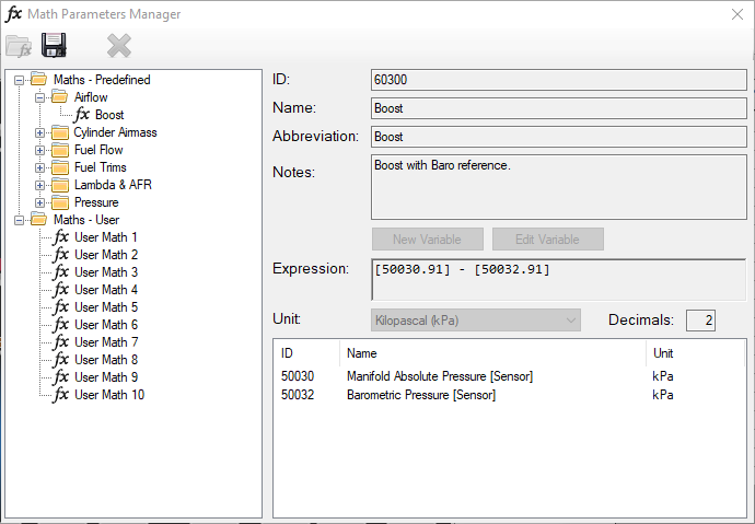

Defining Math Parameters
| 1. | In the Maths - User folder, select the user math parameter that you wish to configure. |
| 2. | On the right side of the window, enter a Name and an Abbreviation for the parameter. |
NOTE: The Abbreviation will be displayed on gauges, charts, and other locations where space is limited.
| 3. | Enter the Expression for this parameter. This is the formula that will be used to calculate the new parameter. See Defining Expressions below. |
| 4. | Select the Unit for this parameter. |
| 5. | In the Decimals box, enter the number of decimal places to show for this parameter's value. |
