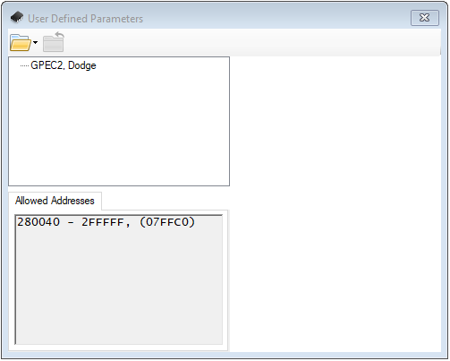

What are the "Allowed Addresses" in the User Defined Parameters window?
The allowed addresses are address ranges that you are allowed to define parameters in. If you try to define a parameter outside these ranges, they will not import and you will not be allowed to edit them.
