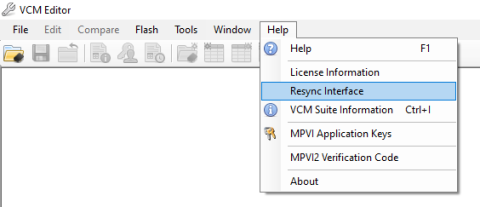

Syncing the Interface
1. Connect your MPVI device to your computer via the USB cable.
2. Open VCM Editor.
3. From the Help menu, select Resync Interface.
4. If the Sync was successful, the progress bar will indicate that the operation is complete.
