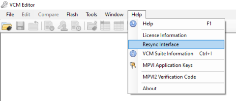

2. | Open VCM Editor. |
3. | From the Help menu, select Resync Interface. |

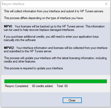

4. | If the Sync was successful, the progress bar will indicate that the operation is complete. |
