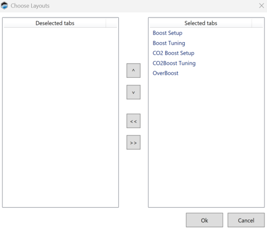

In the menu bar Click Layout > Import layout > From Additional > Boost. |
3.
Select the correct layout needed to adjust your boost control options and select Ok. |

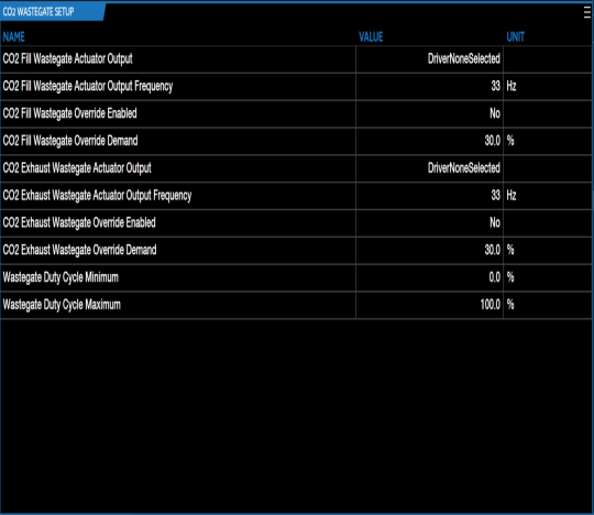

Adjust the CO₂ WASTEGATE SETUP parameters accordingly and ensure all channels are wired and the corresponding channels are set accordingly. |

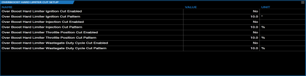

Adjust the OVERBOOST HARD LIMITER CUT SETUP parameters accordingly. |

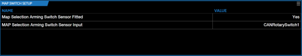

Ensure the MAP Selection Arming Switch Sensor Fitted is set to Yes and the correct channel input is selected. |

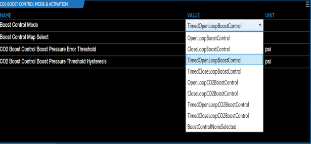

Select the corresponding CO₂ Boost Control Mode. |

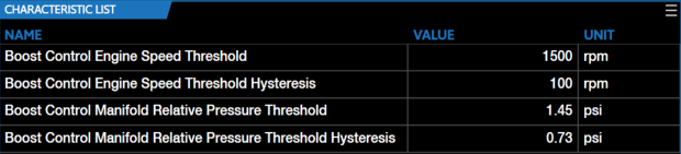

12.
Set the Boost Control Manifold Relative Pressure Threshold to the desired value you want boost control to enable. |
NOTE: Values above the CO₂ Boost Control Boost Pressure Error Threshold will reset the integral of closed loop CO₂ boost control.
13.
Set the Boost Control Manifold Relative Pressure Threshold Hysteresis to the desired value you want boost control to disengage. |

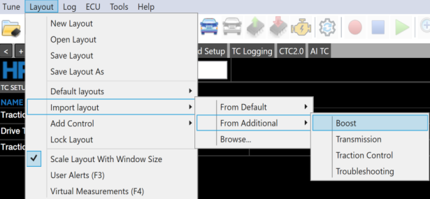

3.

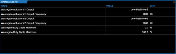

Adjust the WASTEGATE SETUP parameters accordingly and ensure all channels are wired and the corresponding channels are set accordingly. |

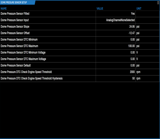

Adjust the DOME PRESSURE SENSOR SETUP parameters accordingly and ensure all channels are wired and the corresponding channels are set accordingly (if applicable). |

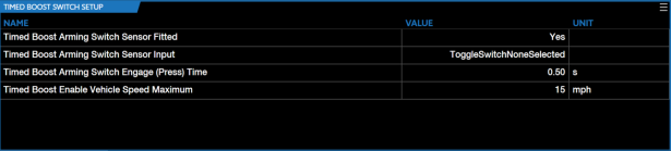

Adjust the TIMED BOOST SWITCH SETUP parameters accordingly and ensure all channels are wired and the corresponding channels are set accordingly. |
NOTE: A Timed Boost Switch is REQURIED in order to utilize the above parameters.

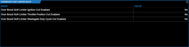

Adjust the OVERBOOST SOFT LIMITER SETUP parameters accordingly. |

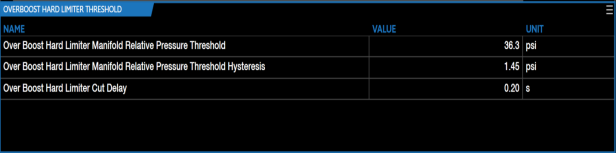

Adjust the OVERBOOST HARD LIMITER THRESHOLD parameters accordingly. |
11.

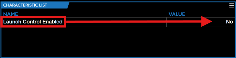

Ensure Launch Control Enabled is set to No. |

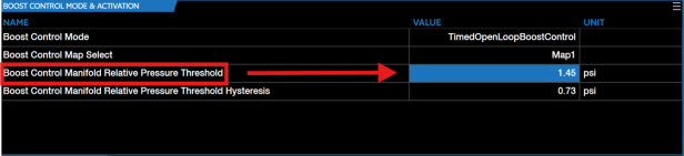

Select the corresponding Timed Boost Control Mode. |
14.

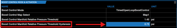

15.

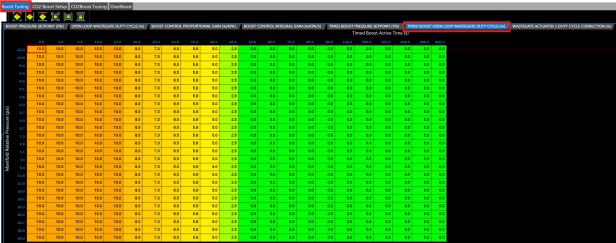

Select the Boost Tuning tab in the menu bar. |
17.

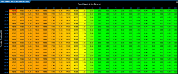

Adjust the baseline threshold by setting the TIMED BOOST OPEN LOOP WASTEGATE DUTY CYCLE (%) parameter accordingly. |
18.
Set the TIMED BOOST PRESSURE SETPOINT (PSI) accordingly. |
NOTE: These timed boost modes are functions of throttle position and timed boost active time.
NOTE: The above table/system will maintain the boost demand specified at the last point in the able. It is recommended to set a safe boost value for the last point to ensure reliability and avoid potential issues.

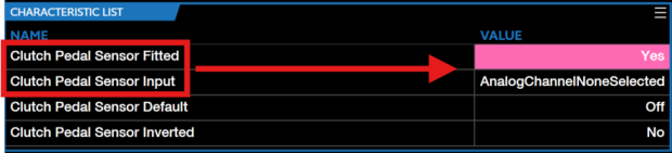

Adjust the below parameters accordingly. |
NOTE: Both the engine RPM and manifold relative pressure must exceed their respective threshold values for boost control activation.
NOTE: If operating with a manual clutch, ensure the Clutch Pedal Sensor Fitted parameter is set to Yes and the corresponding channel is fitted correctly.
