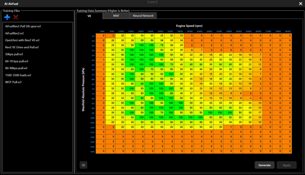

9.
Review the Training Data Summary and confirm that the logged data covers all desired engine speeds and loads. The higher the number, the better the samples are in that area. |
NOTE: It is completely acceptable to have some cells with low values. The neural network can fill in small gaps in the training data.
NOTE: If some areas are missing samples, you can record another log file and add it to the list of training files.

Neural Network: This will train the AI AirFuel Neural Network, which can be used as an alternative to the Speed Density or MAF Airflow models. The main benefits of using the AI AirFuel Neural Network over SD or MAF are increased granularity when calculating airflow, as well the fact that AI Fueling combines 4 inputs to predict the correct airflow (Engine Speed, TPS, MAF, and MAP). |
