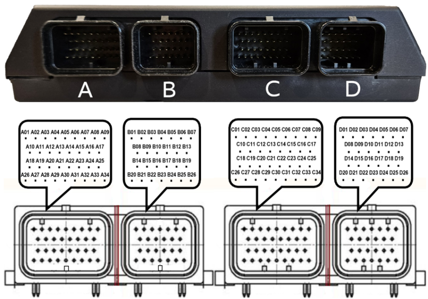

CORE has four connectors on the bottom end of the ECU (Figure 6). Each connector head has 34 or 26 contacts with four rows, combined 120 contacts total with all four connectors.
Figure 6. CORE Connectors (Connector side view with ECU facing upwards)
