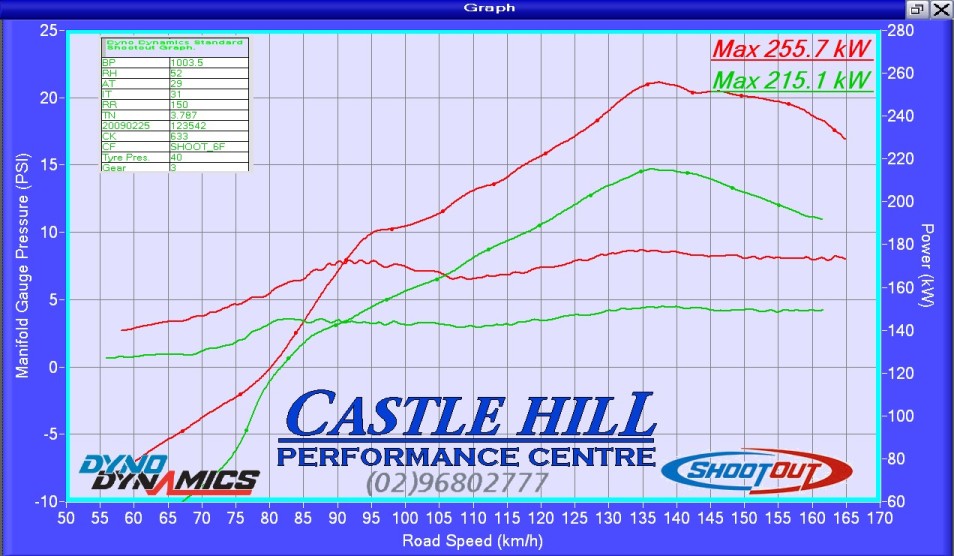

    just finished a BF XR6t,
    only mods were a typhoon intercooler and high flow cat,
    215rwkw stock tune, 255 tuned
  8. #48

    Well done, 40 kw @ the treads gain, customer would have to be happy with your efforts.

    he was stoked.. already booked in for the next lot of mods, being a full exhaust, injectors and fuel pump,
    that was as much boost as it would make with the stock intake and exhaust
