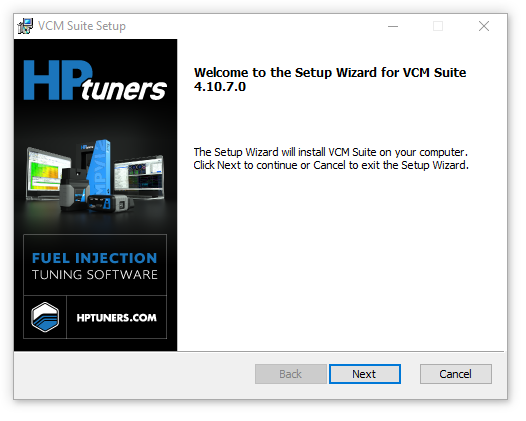

3. Open the downloaded file. The installation wizard will appear.
4. Follow the instructions on screen to complete software installation.

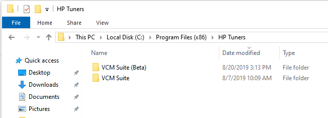

1. Navigate to the folder in which VCM Suite was installed:
VCM Suite is found in: C:\Program Files\HP Tuners\VCM Suite
VCM Suite BETA is found in: C:\Program Files\HP Tuners\VCM Suite (Beta)
2. Right-click on either the VCM Editor icon or the VCM Scanner icon and drag it to your desktop. A popup menu appears.
3. Select Create shortcuts here.
NOTE: DO NOT move these icons out of the installation folder. The software will no longer function if you do so.
