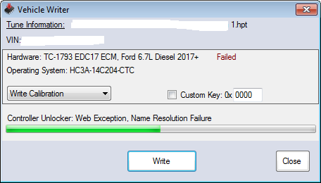

Problem
The Web Exception, Name Resolution Failure error indicates an Internet connection is required but not available to the software.
Resolution
| 1. | Ensure the computer is connected to a good Internet source when reading the vehicle. |
| 2. | If you have confirmed you have a good Internet connection and the problem persists, submit a support ticket and provide a VCM Suite Infolog and debug.dat file. |
