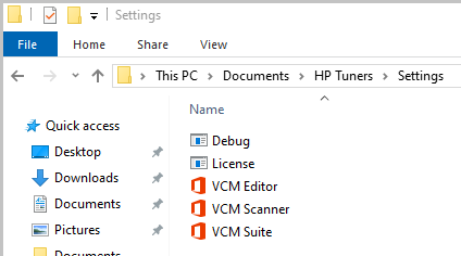

Open a support ticket and provide your License.dat file for further assistance.
You will find the License.dat file in your computer in This PC/Documents/ HP Tuners/ Settings.
